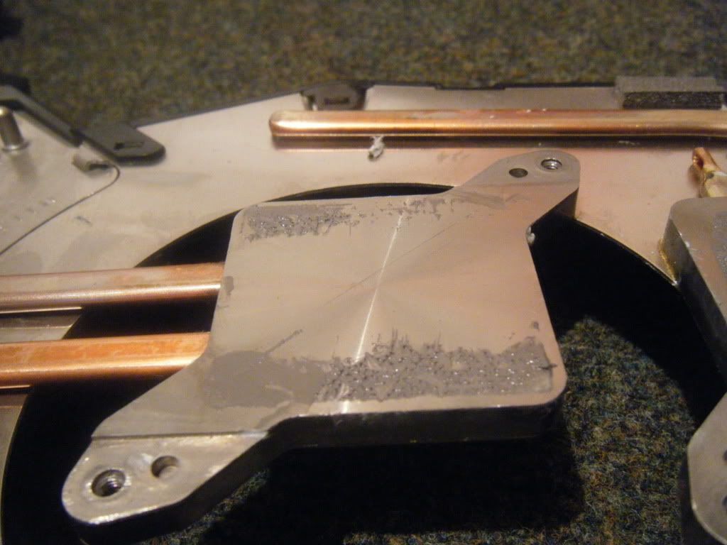

    just took my ps3 apart again.
    I found the reason.
    Warped Heatsink:
    definitely warped.
    Need to buy a new heatsink now...
