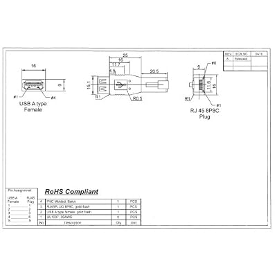

    Stupid thing what I am about to say, I know (please don't laugh), but would it be any possibility of transform any router with USB connection + USB HDD into a NAS unit?
    For example this router with USB connection:
    Plus this cable:
    Plus a USB HDD enclosure like this one:
    I've read this article, and this part seems particularly interesting:
    Other perks include the four gigabit ethernet ports on the back, MIMO wireless technology, and a USB port on the router. USB allows the user to plug in a hard drive or USB flash drive in order to make it available over the network.
    But my point was not buying a new router with that feature (USB specifically for hard drives), but reusing the bunch of routers with USB connection (the one of the first image) that I have on the basement collecting dust...

    Well it's not impossible but there are some requirements :
    1) your router needs to have drivers for this device since it looks like it is just an adaptor with no electronics included
    2) your router needs to be able to share this over SMB, including permissions and folder sharename handling.
    So, if these exist they're probably useful for something, but I think it's far from granted.
