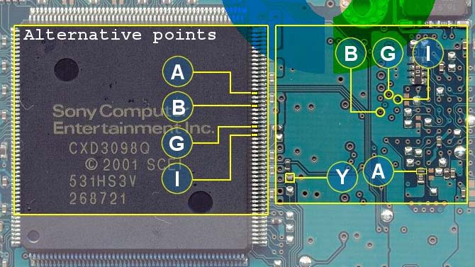

    HELP ! Has anyone resolved the Y point in the GH-O40-12 revision ?

    Look, Villas.... the thing is that my board ain't nothing like that, you see ?
    wanna see my board ? go here ... But ...Thanx anywayz, cause your picture'll let me test out if the a-b-g-i points are the same in both cdx waffles ...

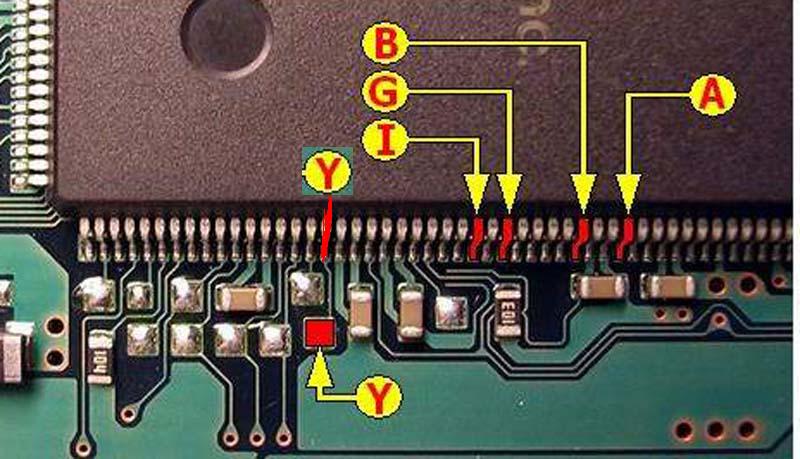

    Plz count 10 pins after the I pin

    Charged is offline Member
    Sep 2004
    60
    Damn you're smart...
    How the hell did I count 16th instead of 17th counting from the left :|
    goddamm
    i'll give you my result in a minute...
    Edit:
    Beh i can't work it out....
    no go on the 12th from I, nor 11th nor 10th...
    a-b-g-i seem'd to be in that exact position of those in the 1rst photo. They're ate equal distances at least...
