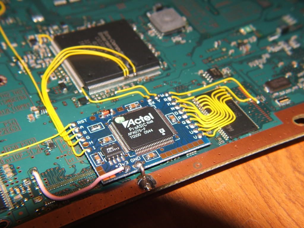

    Before I tear this thing apart again...
    Can anyone recommend the 'accepted' location to mount the chip in a v9 to minimize lead length?
    Thanks!
    jonkim2002 is offline Registered User
    Dec 2003
    5
    This isn't my image, but this is where I put the chip and seems to be the accepted location.
    emccarron is offline Registered User
    May 2006
    12
    Makes a hell of a lot more sense than where I put it. Thanks!
    May 2006
    12
    Re: that last pcture:
    The "H" wire does not seem to be attached. Reasoning???
    broodje's Avatar
    broodje is offline Registered Fruit-cake
    Sep 2004
    Netherlands
    1,181
    3
    H wire is for japanses consoles only.
